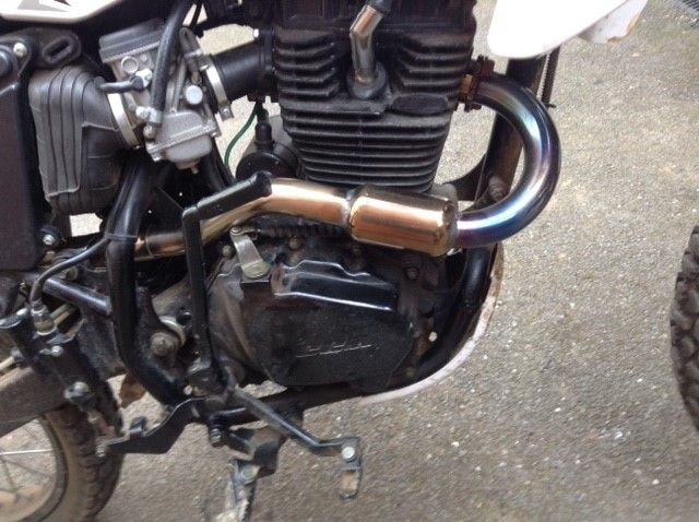

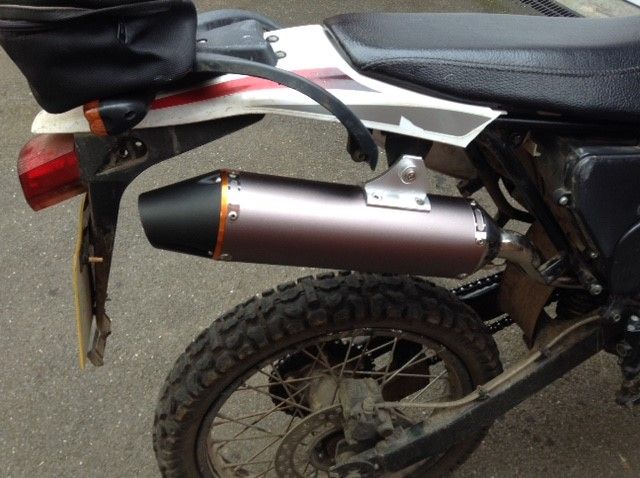

There is always a lot of talk about whether these bikes were the same as the Honda CRF 230, although the engines were not manufactured by Honda, they do seem to be pretty well identical and parts seem interchangeable. To test this out I ordered a replacement full exhaust for a CRF 230 to tidy up the rather scruffy factory item. I fitted it this morn and found everything lined up exactly, the only fettling was to ease out the holes for the two head studs with a round file, although I suspect I would have had to do that if the bike had been a Honda (the replacement was an aftermarket item, but rather nicer than both the Honda and CCM originals). The bike certainly runs much smoother than with the original exhaust, it is hard to say whether any more ponies have been released because of the snow - but I'll try it out soon.

I think the Honda exhaust looks a lot better than the original.
Othen
As does the silencer - very neat and tidy for £93 (whole system).

Look like its running lean judging by the colour of the header pipe, should not go blue like that if correct,
exhaust does look good, good luck with mot
