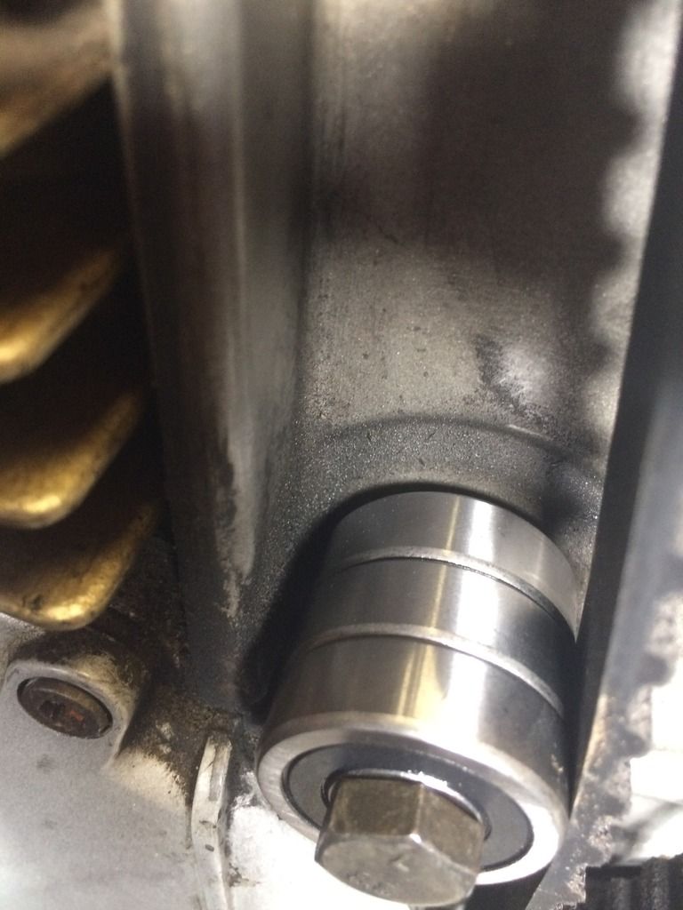

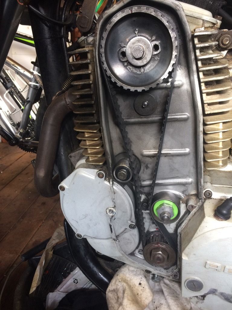

I have replaced my cam belt and idler n adjuster brgs. Had the bike running on the starter and even kicked it into life.
