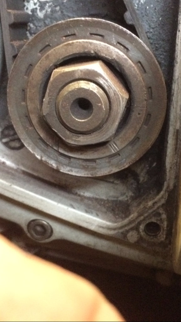

Right guys hope this piccy shows this is a couple of pics of my bottom pully with the top pully and the engine at TDC using a dial gauge down the plug hole. Can this be put right am I on the wrong key way. If so which is the correct keyway. Ta ![]() ![]() |

The mark should be on the top, so wrong keyway |

Ooh are you the guy with the decompresser brackets. Want one. Also what do the other keyway do exactly. 😃 |

the other key way is for the 350cc motor. |
