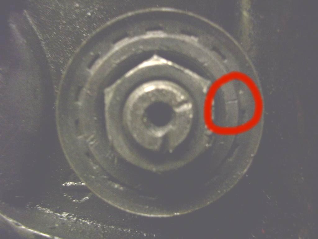

We'll have just removed the timing cover only to line up the cam pulley thru the centre line of the pulleys. And find the bottom pullybdoes not line up. The marks on the bottom pulley look gash. If I can post a pic do these look right to you guys. It is about one tooth round clockwise. The engine did run when I picked it up. How do I post pics guys would show more what I am trying to explain. |

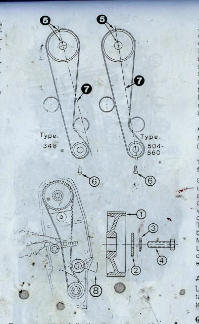

You have to be carefull when replacing the lower belt drive sprocket as it is also used for the 350, if you notice there are several keyways, if fitted wrong then the belt will be 1/2 a tooth out, the keyway should be facing up with the crank locked in place there is a score mark on the outside to indicate ![]()

I got the DTI and checked TDC. The top pulley was close. Belt did have over 15 mm of clearance. Bottom pulley only mark on it was about 4 o'clock. I have remarked my own timing point. What did I buy. |
