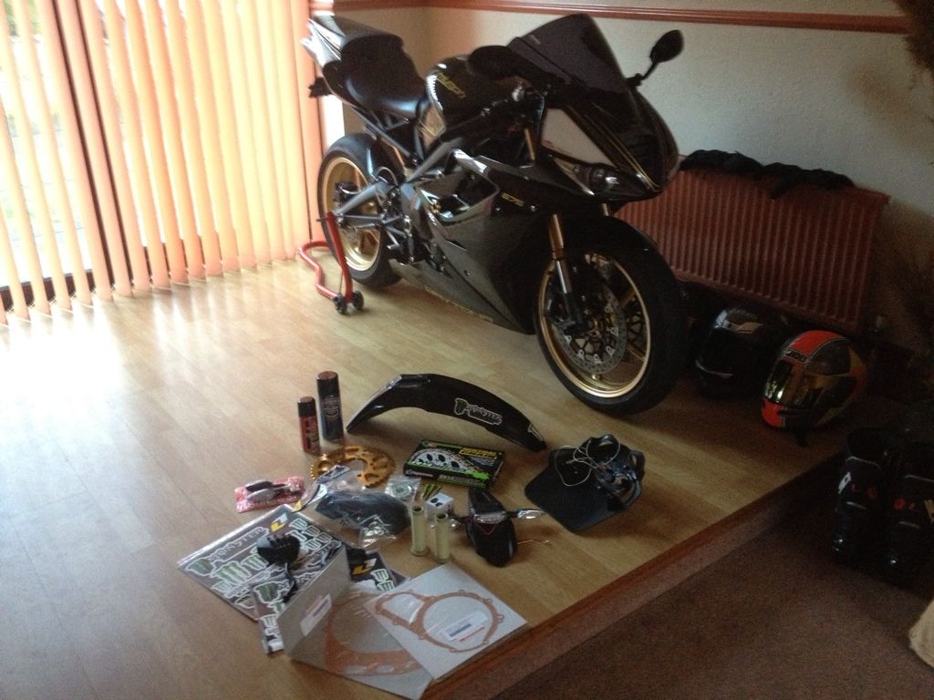

Anyways better pic heres the bits to start the build £150 in total chain was my stock (mate works at renthal) onwards and upwards especially upwards with the gearing :D

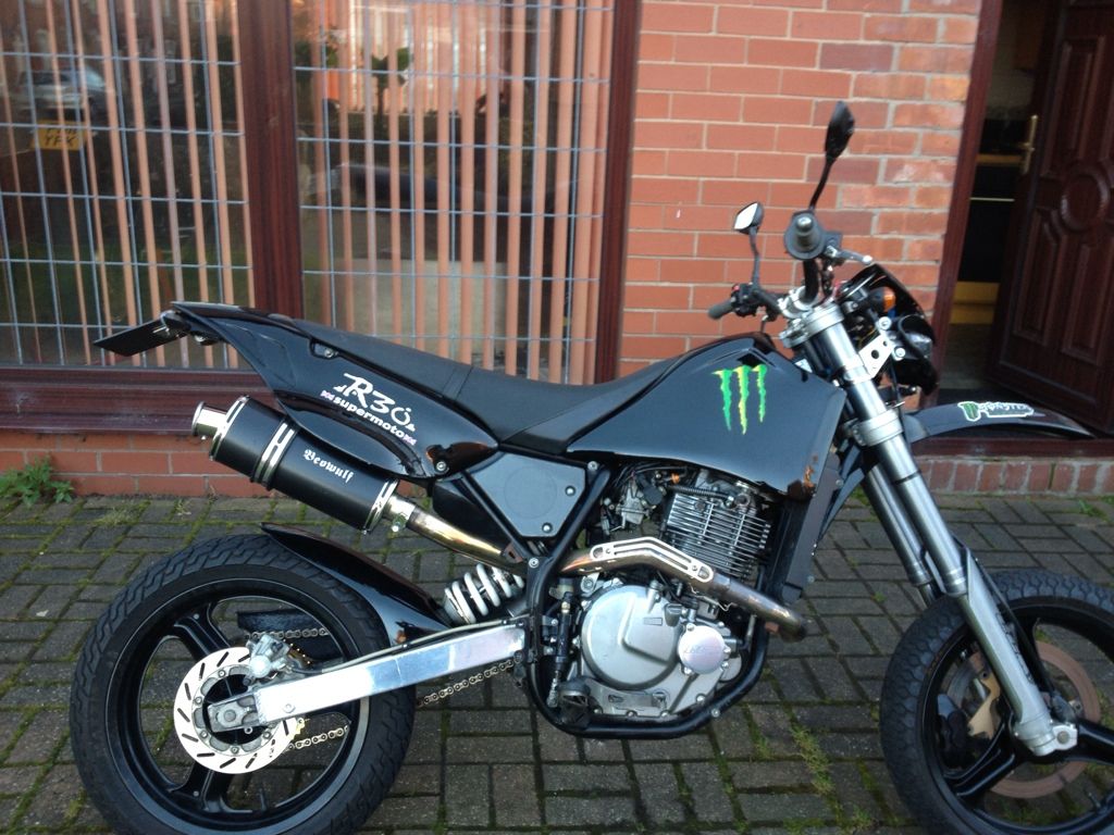

Graphics going on and starting the paint and powder coating
oh how i miss my old bike,you doing a brilliant job on it,keep up the good work.

Cheers Jay you can have her back in march when my big boy comes out and i buy another project shell be minted by then :D

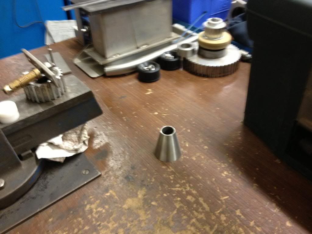

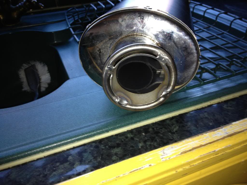

Love the look of the beowulf but after regearing we had a play on the street in front of my house didnt realise the stubby was that loud :( i set off for work at 5am story short ive repacked the can and the stuff that i removed was like dreadlocks anyways not any quieter repacked so ive cut down a dairy tube fitting 1" to 2" and tacked it in with a tig set reports to follow but heres some pics the race cans back on at the mo.
tri675
Sorry folks i do apolagise for the tacks but its just to try it work in progress :shy:
tri675
Slightly quieter but still sounds like a cross between thunder and a bomb going off fueling is improved and throttle response the other can is a remus and it has the full system ibut its too muted i will run this now for a week and chop the plugs and see how shes burning
Nowt wrong with those tacks,
Obviously you wont want to remove the baffle at any time soon ^_^
