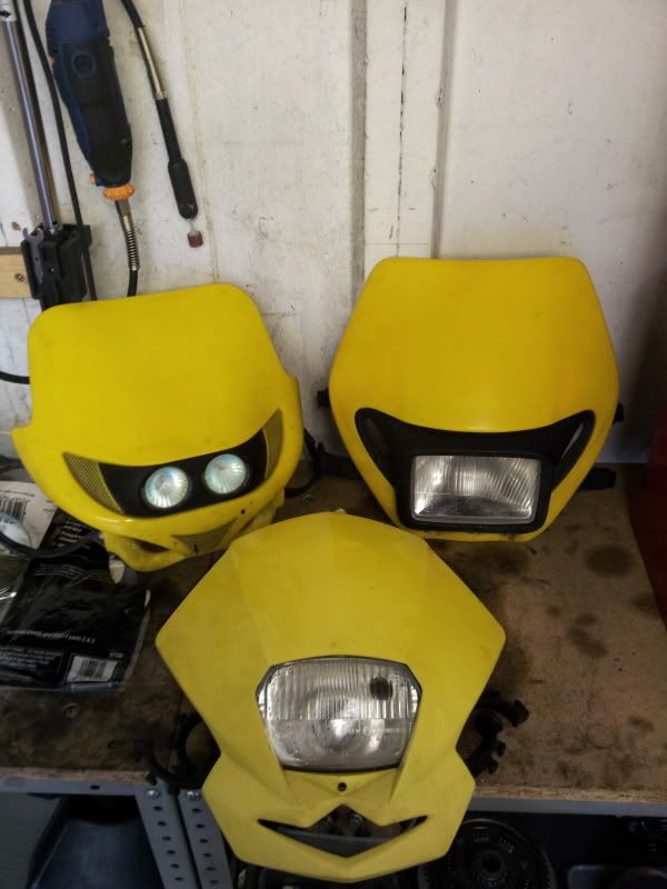

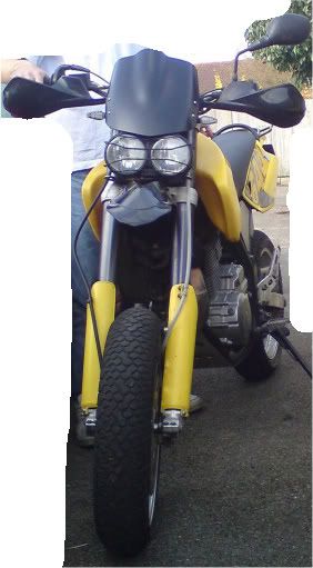

My brother ryan90 was the guy who fitted the Buell headlight, it worked well but he sold it and went for a more enduro style headlight in the end as he never really rode in the dark :rolleyes: This is it.
I had a UFO ray halogen fitted, looks like a proper enduro headlight the same as the standard DS unit, but uses a high power H4 bulb in a proper glass lense which really does light up the road. It's the top right headlight. The other two were piss poor and I wouldn't recommend.
i wonder who did the ray halogen first :angel: lol. i got one and fitted a 55/100w bulb. its a good light but they crack if hit by stones from other vehicles like mine did. i plan to make a plastic cover or a metal grill for it .
you can get halogen ba20d (standard bulb in the ccm 644 ufo headlight) there is a 35/35w or you can get a 55/55w one but be wary of the 55/55w as the one i bought melted the bulb :o
the 35/35w halogen is way better than the standard one

I have the top right one in the pic and it's great at night, just had a bulb upgrade :unsure:
is it a plastic lens on the headlight? if so its the standard one .the one in that pic is a glass lens .they were standard items on early 90s ktm bikes

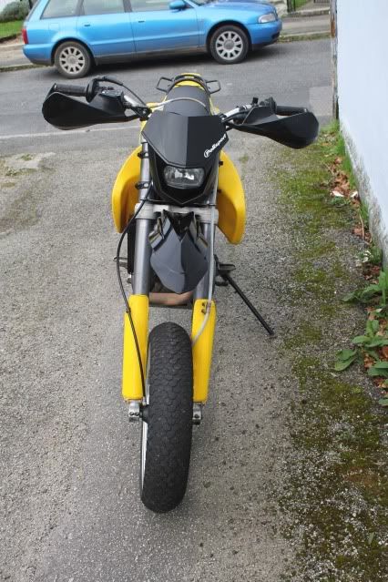

Ryan90
I ended up swapping the buell light as it just didnt look sporty enough and i wasnt riding in the dark as much as i thought i was.. I went for this after:
Still has a h4 bulb so way better than standard, wasnt as good as the buell setup but wasnt bad by any means.

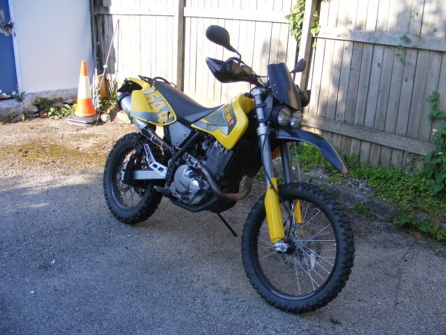

The buell looked good with dirt wheels and fender though:

morepower
What's the mudguard off with the polisport light?
Ryan90
Oct 31 2012, 12:04 PM
That's nice bud 😊
Ryan90
morepower
Oct 31 2012, 12:30 PM
Was just an acerbis sm one off ebay, the other one with dirt wheels on is a ktm one.

stickerz
bighit
Oct 30 2012, 09:08 PM
stickerz
Oct 30 2012, 08:49 PM
It's glass
