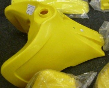

Can anyone tell if this is a Suzuki or Rotax tank?
I know that the rotax tank needs a recess on the underside to fit over the top of the rotax engine. As I can't see the underside, is there any other way to tell?
Apparently, this one is from a 2002 Dual Sport, which I guess is a black frame bike? Is it likely to fit my grey frame 2000 rotax bike?

im pretty sure that they made a few 644's in 2002. can the seller not answer the question as there is no other way to tell them apart.
2002 was a change over year, both engines were used.
chances are its a suzy tank,
150 sqid just for a tank is a lot.

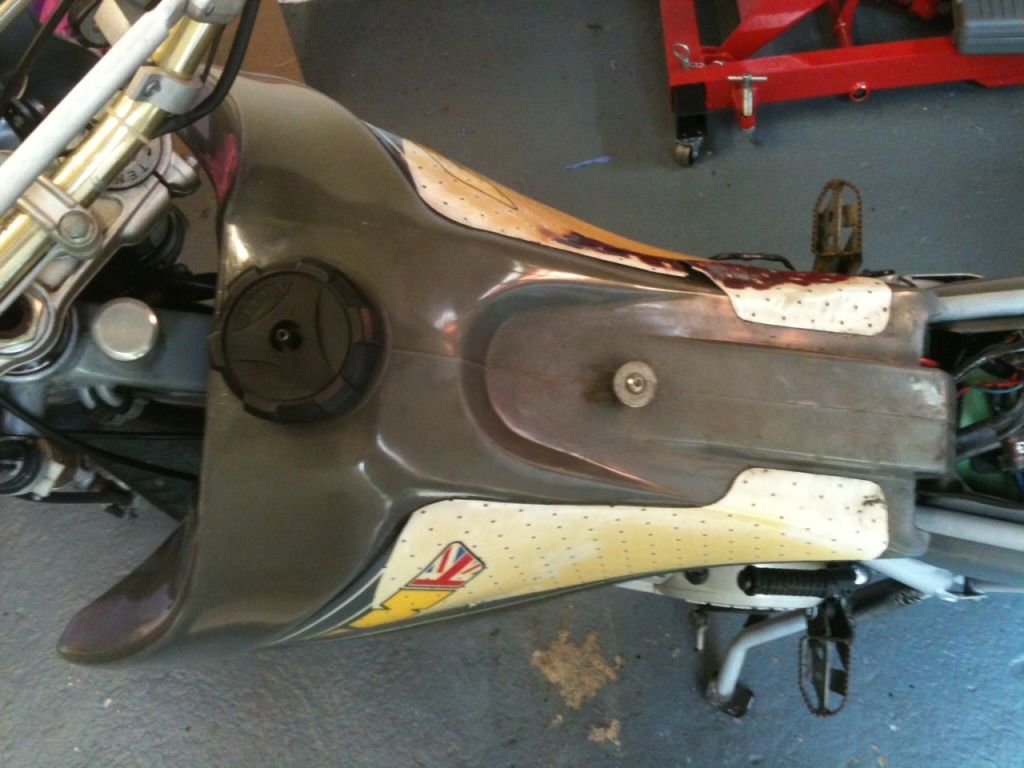

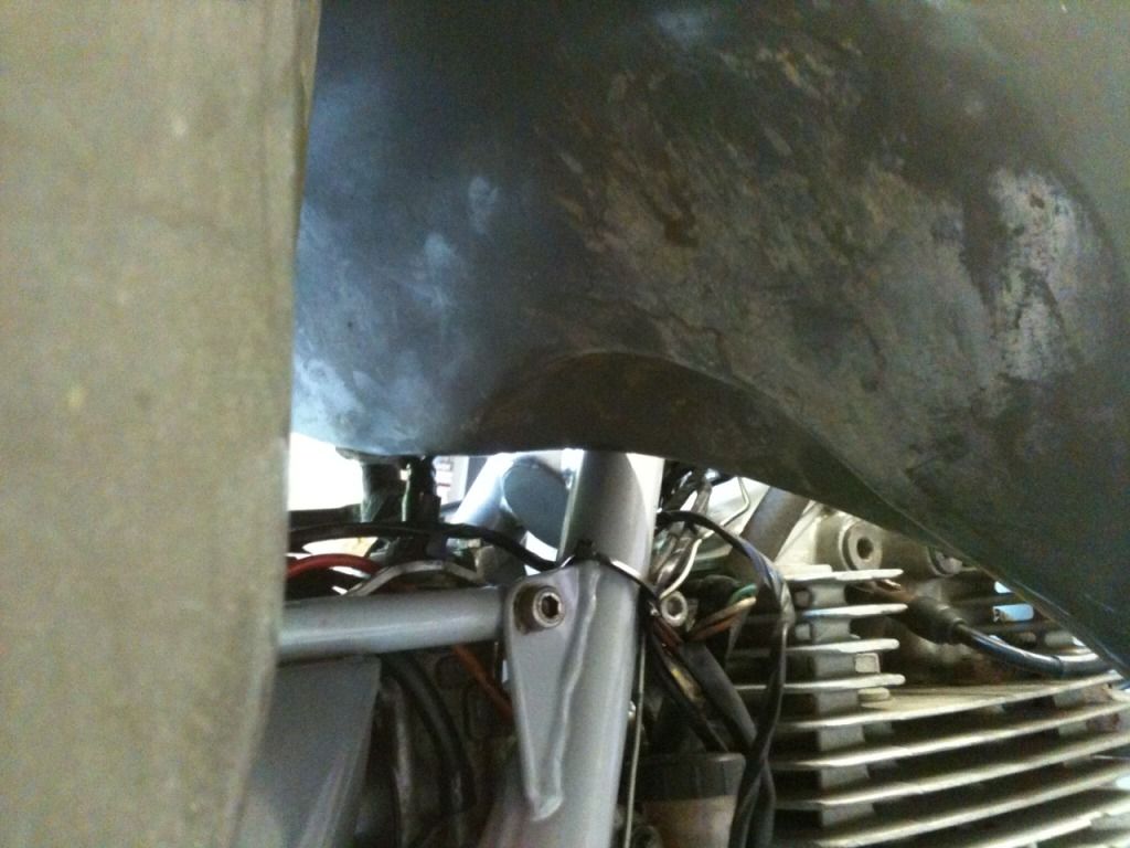

The rotax one has this curved recess on the underside, where it fits over the top of the rotax engine
This is the top view..
What condition / colour is yours? Please drop me a PM if you're interested in selling it.

Oct 19 2012, 06:44 PM
I would say its definitely a 644 fuel tank - in the second pic you can see the recess for the radiator on the left inner side (seen from front)...hopefully I`m wrong :(

Thanks Chris. I think you might be right. I've just been out to look at my rotax one and it doesn't have that long recess (where I guess the radiator would go).
Mikb
I have had a lot of rotax tanks over the years, small and large and none have had the recessed filler cap area.
I would say definately 644.

Well spotted Chris. I remember on the old site that there was talk of a tank that fitted both when they moved from Rotax to Suzuki,which would be 2002. I have never seen one,anyone got one of these? The only sure way of finding out if this is one of them is to get the guy to photo the underneath.
