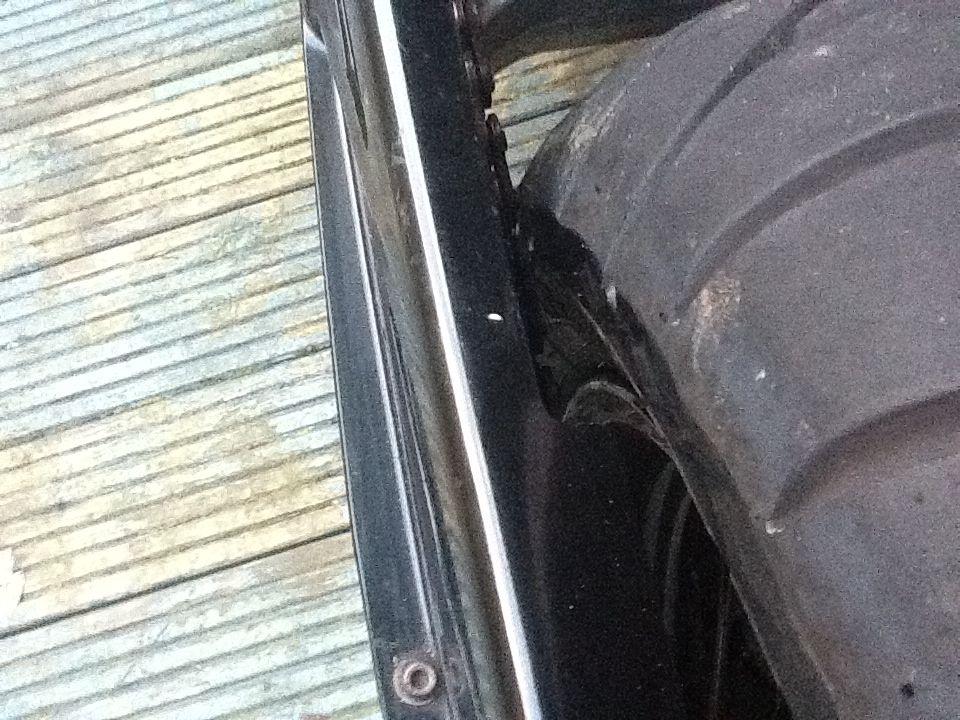

:( Well chaps had my first good outing today on the r30 loved it plenty of grunt and fun but the last owner gave me a brand new 160 tyre and I got it fitted local I didn't Evan check the chain clearance and this happend see pic please
Now all the chain side edge is worn away should I go back to a 150 ? And has this tire had it :(
I didn't see it till I got home very lucky I think ,any help with all all weater super moto tyre would be great :bye:

hardly any 160 secrion tyres fit our bikes. i found out the same with the michelin pilot power . i had not used the tyre yet so i got it swapped for a 150 . my tyre on the bike now has a worn edge and its due to the chain guard being cut shorter by the previous owner . that was flopping about and worn the tyre .

is your chain adjusted correctly? if its a little slack it can nick your tyre.
i had conti road attack 2's before that looked like yours with the chain nicking and they lasted just fine for 4500 miles, but at the end of the day its what you feel comfy with.

Chain could do with a tweak TBH should I change the tyre or will it be ok for a while? no handling issues at all just worn On the chain side ,it just shocked me it's pretty worn
its hard to say by looking at pics.
i know my conti's looked bloody awful and i think i was getting about 3mm deep nicks but with that said i cant sit here and tell you it'll be ok though as thats your call.
give the chain a tweek and see what the side to side movement is like .. if you think it hits the tyre too much for peace of mind then change it.

100% with johnny on this . its your call .

if you get the conti in a 160 it WILL get nicked by the chain again, your need a 150.
the other thing i forgot to say was how old is your chain, as if its nearing the end of its life it will have alot of sideways movement.
Whitey r30
I'm not sure how old it is but it has got a little play either side I'm going to get a new chain and sprocket set over the colder months 150 is they way to go I think and the 160 is a bit slow turning in 150 will make it a bit sharper I'm hoping ;)

it all depends on the tyre makers sizing . a goldspeed rear is 160 and it fits but look at the side of the tread , on other tyres there is a cliff like over hang then the side wall . on the maxxis goldspeed the cliff is not as pronounced .

The only 160 profile which I know 100% works on the CCM's is the Maxxis goldspeed as it's a skinny 160 :rolleyes: , go for a 150 otherwise you are going to shred another tyre.

Thanks fellas now sorted got the same tyre new but a 150 so it matches the front a bt21 £110 free post was the best I could get :dirtbike:
