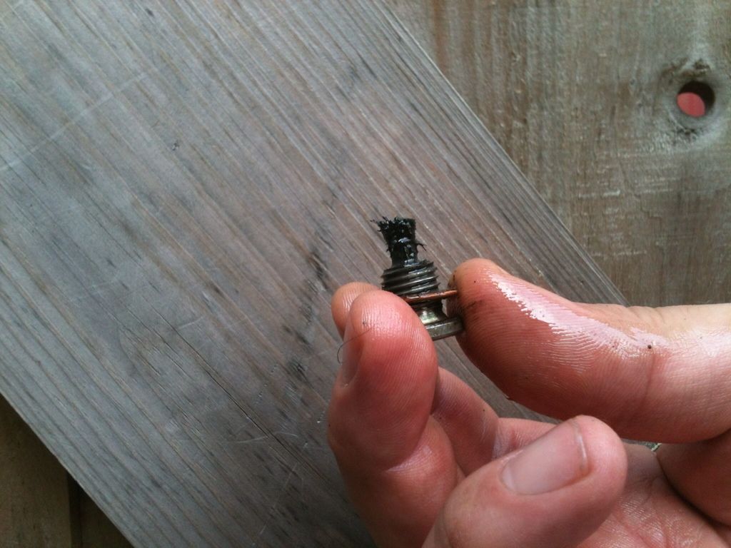

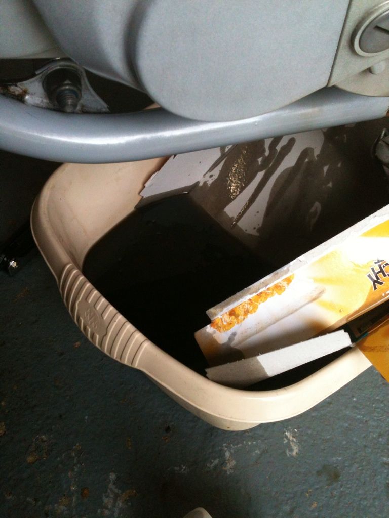

As you know, my new oil was flooded with fuel when a carb seal failed. So, I decided to change the oil (again!).
Bearing in mind it's only been in there a week and done about 1.5 miles, it was pretty black again..

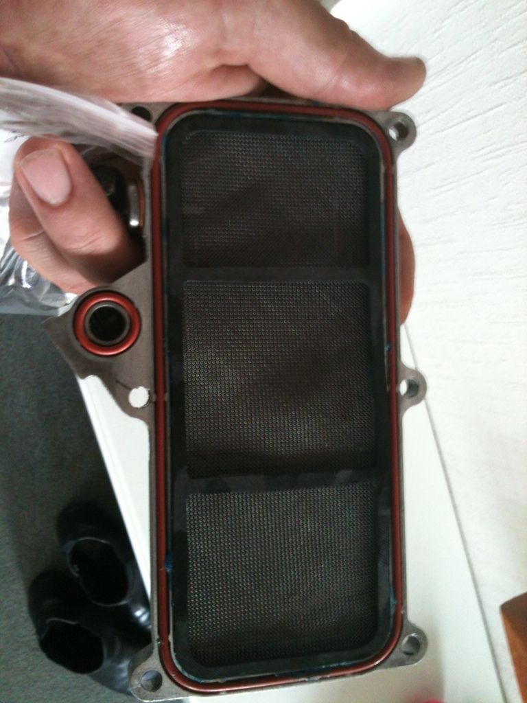

Whilst it was out, I thought that I might as well remove the sump and replace the strainer, o-rings and gasket and also clean the magnetic sump nut.
When I'd filled it back up with oil, I looked around to see that I had managed to knock 3 litres of new oil on the garage floor :rant: :rant:
