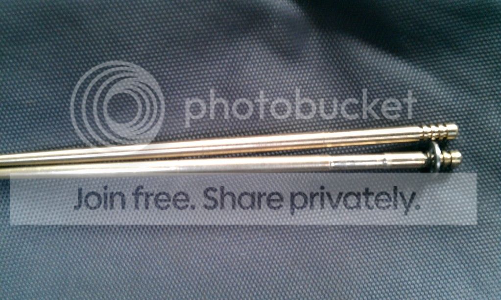

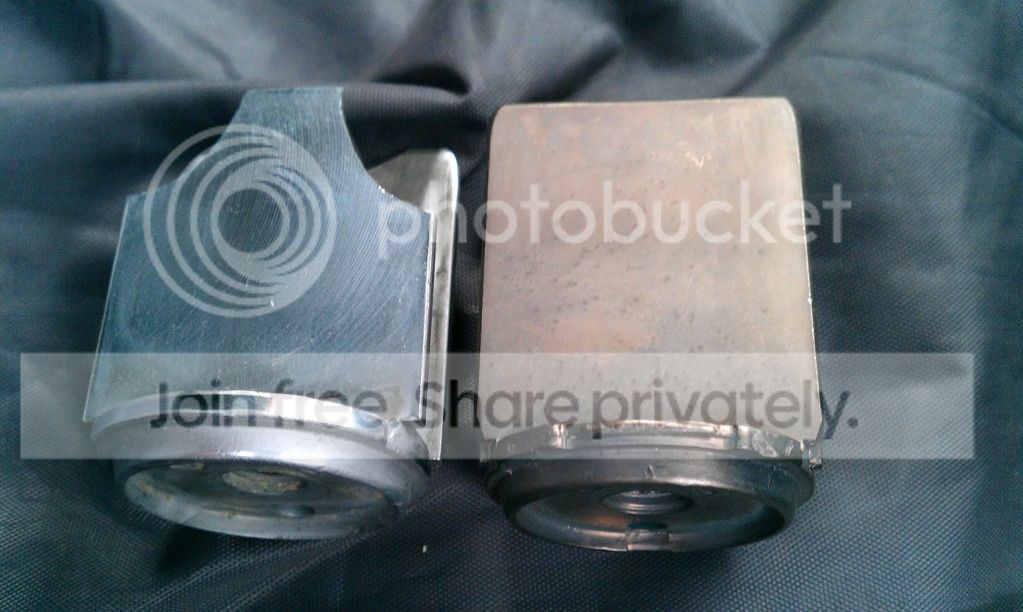

ok mine has a VHSB 39 nd dellorto, it looksd like the one in the pic. if you open the link it will give info on how to set the levels . if you have one like mine the bottom pic o the left is the right setup. it appears the probs that i had were caused by pieces of the slide missing and ware in the needle and the float valve . i changed them all and the bikes never been so good. thanks cuz My Webpagehttp://www.dellorto.co.uk/images/parts/floatlevel.pdf |

Nice pictures Watts,its a wonder it ran at all with the bits missing off the slide. Are the slides made out of metal or resin? Glad its all sorted and running well,must feel like a new bike
| watts | Jul 22 2012, 02:28 PM Post #11 |
runs really well thanks mate , the slide is an alloy
