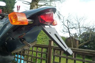

Just fitted this to my R35, as the CCM factory tail/number plate mount decided to leave home after a bit of a canal bridge flight trigectory. It can be bought from a CCM jockey based in Thailand called Karl who has an add on a popular auction site. kawasaki-ksr110com. If you intend to fit this super light weight sub tail assembly be aware that the angle of the dangle of the number plate means that only the police helicopter can read it. Thus modifications had to be fabricated. IE. sever the numberplate mount and rebracket it at an angle more suitable to being read from behind and not the air .Two rainy afternoons pissin about in my sacred shed. Posted Image

Looks good , nice job
rossonza
Seal the unit with silicon!!!
All around the edge and where the wires go into it.
I broke 2 due to water damage. And the number plate light broke after 3 weeks.
Think its luck of the draw with the quality
