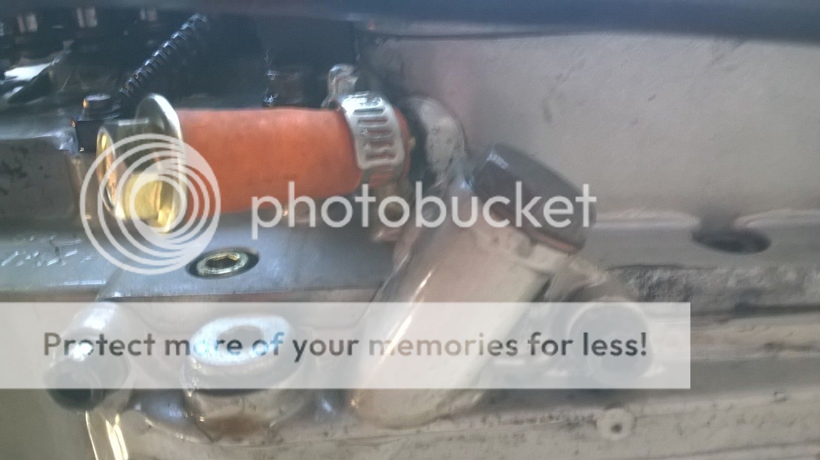

been outside before I head out for a night shift. here is the pipe I was looking at![]()

| Sportax Racing | Aug 29 2016, 04:58 PM Post #17 |
Un block it ASAP!!! Thats how the engine breathes every time the piston comes down! It should go up to the air box... |
| Monty | Aug 29 2016, 05:23 PM Post #18 |
Gary it may on the MT's but its just open on the CCM |
| fattyjr | Aug 29 2016, 06:55 PM Post #19 |
looks like a previous owner was a git. I'm going to make up a little stainless tank to fit in the tail like I did on my buell xb12x as it's a common mod on those. As soon as I get the bike running and sounding good, I am going to make a new silencer if you can call it a silencer LOL Any "how to" on how to check the balancer shaft? I am assuming looking at the exploded parts drawings ![]() I'm going to have to split the cases and check the measurement between the internal bearing faces and the shoulders on the balancer shaft. |

| Sportax Racing | Aug 29 2016, 07:40 PM Post #20 |
Yep but good practice to vent in the air box.. better than all over the rear tyre!!! |
