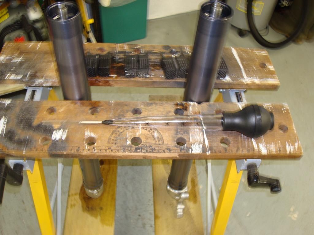

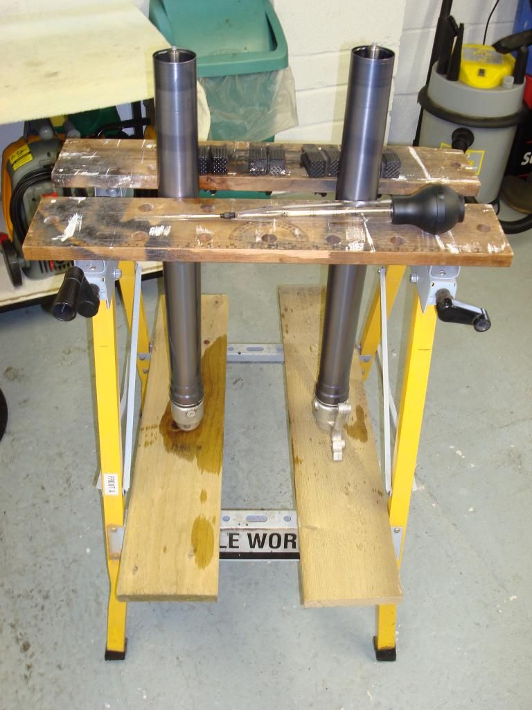

Just done the fork seals on mine and my top adjusters don't click as such but you can feel them click as you turn them if that makes any sence also the sprung plunger rod that fits in the adjuster had siezed on one fork leg (coated in a nasty black residue !! not sure what it was ? ) when servicing the forks i found a black & decker type workbench very usefull i will post a pic as soon as i find my Photobucket password

Comes in very handy when filling with oil and putting top caps back on, also note the wifes basting thing !! best one is with the metal pointed attchment on then you can push on a length of tube the correct length for the oil height and suck out the excess oil and bobs your uncle perfect oil level
