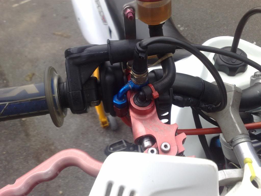

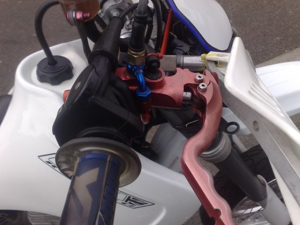

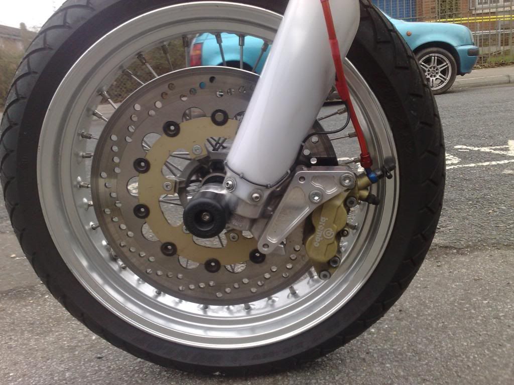

I've got a Brembo 4 pot caliper on a 320mm disc (with a poncey bracket)
also running a Beringer M/C & it's about as good as you can get
The main advantage is you can run almost any 320mm disc (as Beringer is 310mm) disadvantage is not all 320mm discs are Cast Iron, & cast Iron is very good in the wet, but maybe if you want you can find a cast iron one if you try?

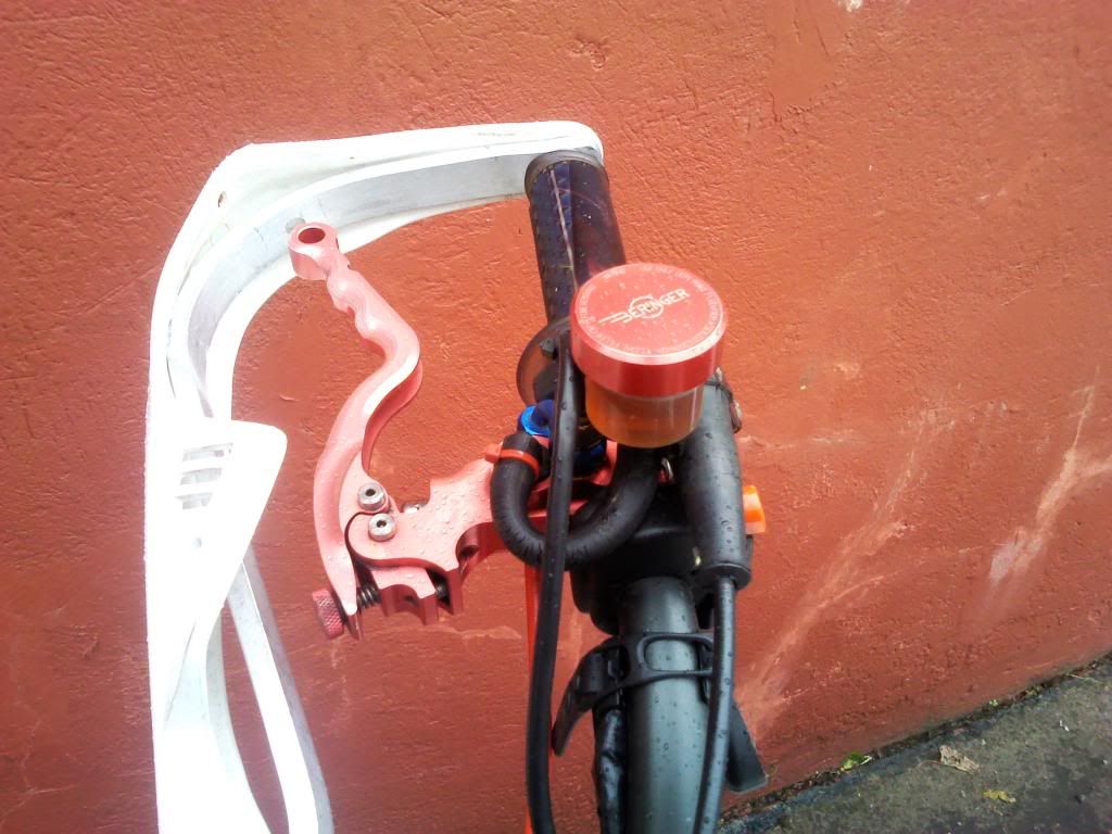

as for mine, ive got a PT (performance technology)radial lever on mine, that was only about £150 , as opposed to a brembo which i paid nearly £300 each for mine on my fighter... it works superbly too...

Steve,
where did you get your caliper adapter bracket from?
