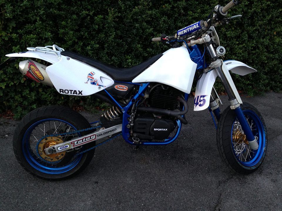

when i trust a product, it will get a sticker on my bike. Today it's wearing some Sportax love. very professional,great quality products,friendly, willing to help and a love of the Rotax engines. cant really speak highly enough of Mr Gary Sportax.

next time i'm over Gary i shall hand you the keys :) running in is going well, i didnt do the trash style, i went gentle for the first 160 ish mile, then iv'e been opening her up slowly with the odd good blip, it'll be all done by the end of the weekend :) koban .. are running a PHM 40 .. or the VM44? |

Vm44 Johnny and your bike looks great. Cuz found the bike ticks over better with the 860 cam, well it did with the 40 pilot. Fitted a 45 pilot to give me a bit more adjustment on the air screw but it stalled pretty hard. The ingitech is working great with the 860 after a bit of remapping except I can't get it to kick over. I tried the base advance at different settings but didn't even try to start. Starts instantly on the button. Love the 860 cam really pulls . And you can get the midrange back with the ingitech so it's almost straight through. |
