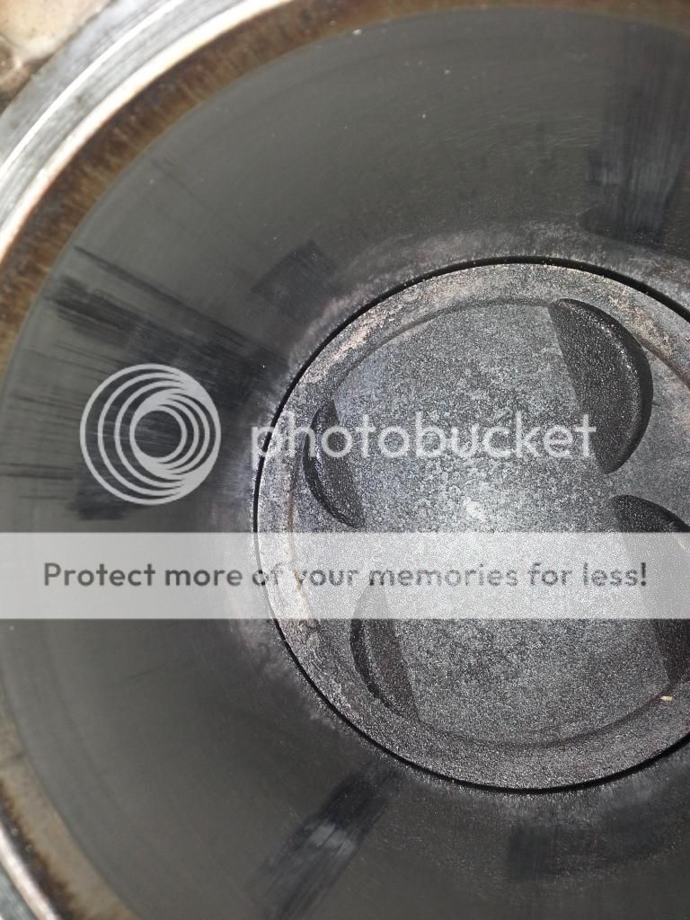

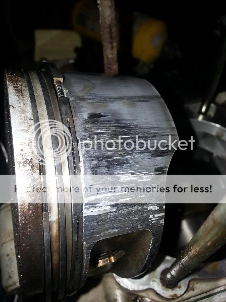

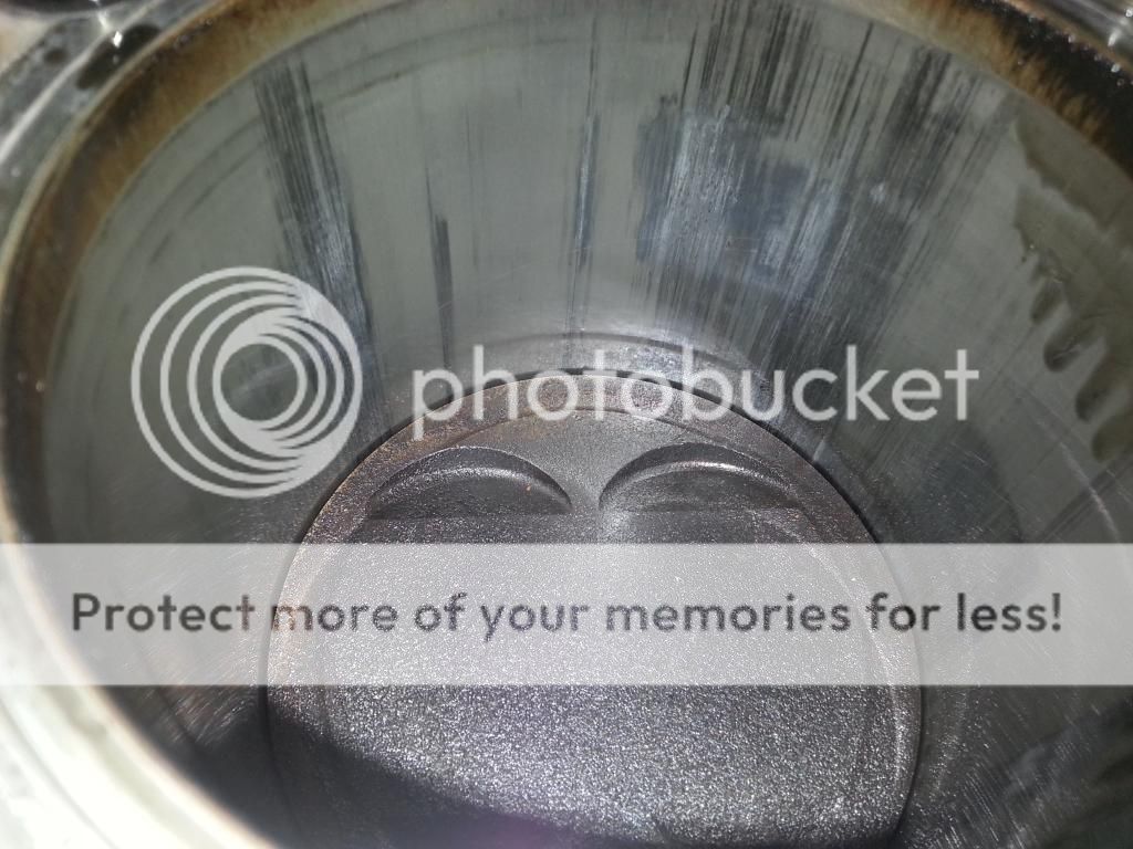

Motor stripped and all is well with bearings.. no play and no signs of wear. Damage limited to piston and cylinder... One odd thing tho it has only 8 clutch plates and v heavy duty clutch springs.. Its an mx motor so probably played with by previous owner. Sprag is also like new so no dramas there either.. pics to follow when i work it out! |

Cheers re pics Mark and Jonny! I'll email the first batch later to you Mark until Jonny sorts my computer skills out! The replate will be just to standard 604 and a new piston and rings - probably the most economical way to get it back up and running.. head and Valves will get decoked so all should be up well on the testbed next week! |
