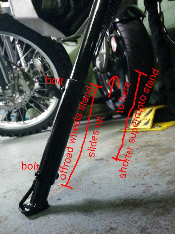

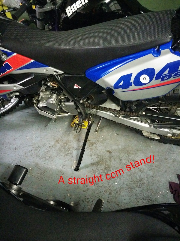

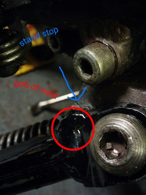

Sorted the ccm's stand out, we cut the foot off and bolted a peice of tube in between. There is a bolt through the foot and the tube, and also a bolt half way up the stand through the tube (giving you the added height for off road wheels and the ability to slide the tube up for Supermoto, making the stand smaller) The pictures will probably do a better job of explaining. ![]() We also put a bit of weld where the stand rests on the stopper, because the stand seemed to sit too far forward creating a bend and all that flex in the stand. This just pushed the stand out slightly. ![]() And finally we straightened the stand out by heating it up, putting the end in the vice and bent it straight with the leverage from a scaffold tube. ![]() Then sprayed it black. Edited by Sam, Apr 25 2014, 12:42 PM.
