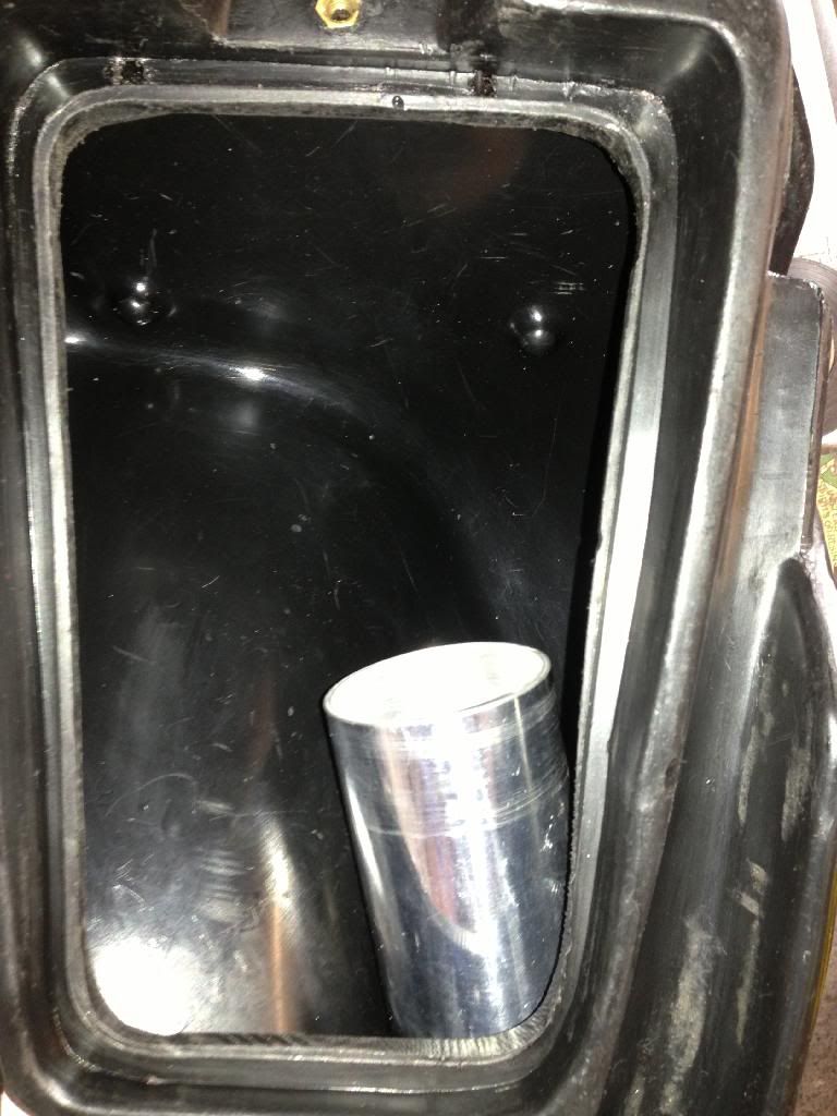

After deciding like many before me that the standard 404 air filter is a pretty poor design I set about coming up with a solution . I took a flap wheel to the neck of the airbox and glued in a55 mm aluminium tube which had a slight bend in onto this tube I fitted the largest ramair pod filter I could .you may also notice how when fitting yz mudguard I left some length and attached near air box for extra support . Hope the picture comes out

This isn't a very good pic . I used a flap wheel to open up the neck of the airbox because I wanted to use the largest tube I could.if you wanted to use the more readily available51mm you might not have to open the neck up . The tube you need needs a 45 degree bend which you end up nearly cutting in half. I fixed in place using araldite ![]() I left the tube a little long so I could change the filter without removing tank |

Would you need to rejet the carb if doing this mod ? What about this pod filter then a piece of the universal filter foam over the opening of the airbox like in another thread on here ? Kind of a pre filter before the pod filter . Anyone tryed that ? I can only find the Ali bends in 51mm and 57mm diameter . Does anyone know were I can buy a 55mm one from ? Thanks kito Edited by kito, Nov 15 2014, 03:50 PM.

doubt you'd need a rejet i wouldn't put a flat filter across as well, cos it would strangle it |

Tried a very similar set up on the Dyno, significant power loss over standard filter |
