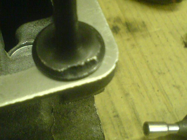

i would say the tappets may be too loose . dont tighten them more than the spec though or you will get burnt valves like this ![]() that was in a head that had been shimmed up wrong . the clearance was 2 thou when it should have been 10 thou. the valve was a little open when it should have been closed . the valve not closing was letting the exhaust gas out when it should have been sealed and its burn the valve away . there was burning oil too mind you . re check the clearances . i cant remember off the top of my head but we dont go any lower than 5 thou at work on heads even if the makers say 4 thou . a single sheet of newspaper is around 2 thou also is the 644 an interference engine ? for example if you time it wrong ( 180 degrees out of time) would the piston kiss the valves ? could be the piston hitting a valve . although the valves when new would be machined the same they wear different so one may be a tad longer than the other and its kissing the piston . i once timed my 644 wrong but i noticed before i turned it a full turn . might be worth popping a plug out and using a wooden dowel in the plug hole to find if its timed on tdc Edited by bighit, Mar 28 2013, 10:25 PM.
